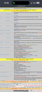

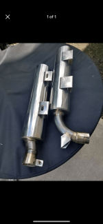

So my vin lands under the later year roadsters it's a 2018 is it ok to put an older map in or am I going to fry my ecu? It has a ram air and I'm about to install Dave platt dually's

The 2010 to early 2013 Roadsters have their own map and the 2013+ Roadsters have another map.
Not cross compatible. Due to a change within the clocks in 2013.
If you load an early Roadster map to a late Roadster ECU, the check engine light will flash and the bike won't run.
However you can copy each of the tables from the early map across to the later map, and save it as a new map file and that will work for a newer Roadster.
How do I go about coping the tables I’m using an android tablet still really new to tuneecu only used it once on my old touring model and it was easy just a straight upload
First download the original map to save in case you need it later.
There are some tunes on here for 2014+ on here under the resources tab. I've use 2 different ones on my 2018. If you are on a mobile phone, you have to turn your phone sideways to access the resources tab.
