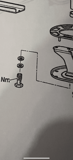

I am suspect of my vacuum hose routing. I have removed the charcoal filter and need a smart person to tell me how to reroute or eliminate the vacuum hoses for that.
At the bottom back of the throttle bodies as they sit on the bike (between throttle bodies and cylinder head), there are 7 vacuum nipples.
The 3 circled in yellow are connected to the MAP sensor via a 3-1 collector.
The 4 in blue are the remaining ones which are capped like shown with blanks on non-Cali (afaik) bikes. Cali bikes have the evaporative loss control crap under the left side cover. I assume this is what you mean by charcoal canister. Down there you have to be careful not to mix up the vacuum tubes up with the 2 breather tubes from the gas tank. As long as these evap loss control system vac tubes are blanked off it should be fine. Best removed altogether and nipples blanked like shown here though.
Oh yes and one thing I think I learned is it critical that the MAP tubes are the same internal diameter and length as the stock ones for the vac pulses to reach the MAP sensor right (if replacing them with non-OEM).
Thank You Arto. Good info.
I have the 4 blue piped together. Maybe I should cap them off to be sure there is no vacuum leaks.
The 3 in yellow to the MAP. However they may not all be the same length as I had to move some things around. I need to check the MAP hoses.
