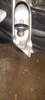

Don't trust the arms for that luggage rack to hold much weight. The stock setup is rated at 3kg (6.6 pounds), and that ain't jack. Many have snapped them (yeah, me too.. but I was using it to hold a big flag mount. I buddy is fabbing up a much stronger one now.).
Here is what I used to add a tie down point for my tail bag:
Attached to the bottom of the passenger pegs with existing bolts.
What a great idea. I think you’ve just solved my dilemma👍 Thanks a million👍👍👍👍 using these I can now strap my soft luggage to the pillion seat😃
Make sure you test how the tips of those pegs will rest against the bike with tension on them. For me, they hit right under the seat. You might want to pad those tips to prevent any scratching. Also, I had to take just a bit of the bend out of the mount on the right so the mount did not hit the shock cylinder with the pegs retracted. Good luck!
