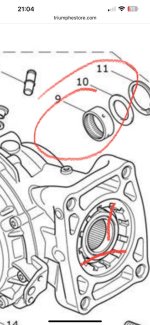

Left side of bevel box behind the cover.
Found it, hated to ask, im sure youre mad after doing that, thanks for sharing, i do when i make mistakes, may my mistakes help someone else ( ive made make alot) learn and move forward
