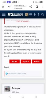

Further research I found that a remedy for the early rocket transmission issue was to remove every other dog on one of the main drive gears. This would account for the extra slack.
Here's a screenshot about the gear change related to engine numbers.
The poster was also inquiring about drive train slack.

I know my '07 has the 4-window dog's, and I assume my '05 must have the 6-window version. I wasn't sure why Triumph made the change. Was it to reduce slop, or to make gear changing smoother, or ???
