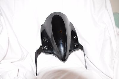

One of the best aftermarket options is the Giant XL flyscreen version that was sold by a UK bloke David Gill who runs some Rocket III facebook groups. He sold them on his website Rocke's Patches UK

Jason Dunne Fiberman on FB Triumph Group has aftermarket standard size and XL fiberglass versions of the flyscreen now too.

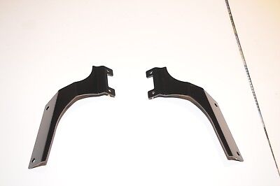

No brackets from this guy just the screens BUT Dave Gill still has 2 types of brackets to suit factory or aftermaket flyscreens. One is angles more steeply giving much more access to the keys and raises the angle for more protection (these replace the Triumph side brackets/plates but still fit the factory fork fixing clamps)

Stock Triumph flyscreen
Compared to much wider and taller XL Flyscreen from Dave Gill UK.

Jason Dunne Fiberman on FB may be your best hope for a Giant XL flyscreen made.
You would need to get the side brackets separately from Dave Gill's Rockes Patches or the his eBay site 'toyota6510' and ALREADY have a set of 4 fork fixing clamps as you do already.
