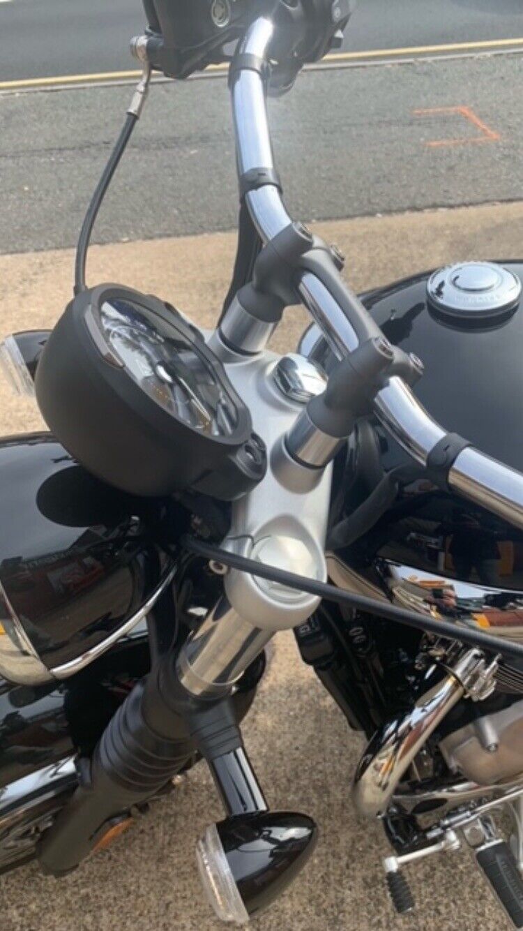

I just took the plunge and installed Thunderbird risers on my 2013 R3T. They look and feel great. I now have the clearance necessary to mount my touring windshield. At initial sit on the bike they are great for pull-back with very little rise. I have a long ride planned in the morning and will quickly determine if this is the right setup.
Risers are paired with OEM bars from a Honda Valkyrie. Slightly narrower than the stock 2013 bars.
Pictures to follow.

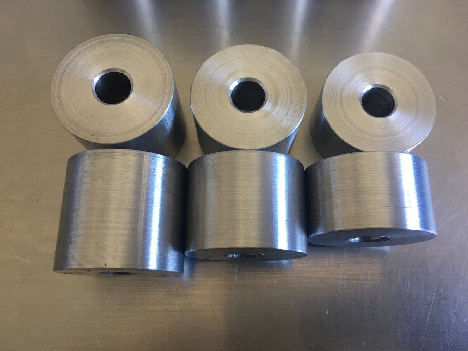

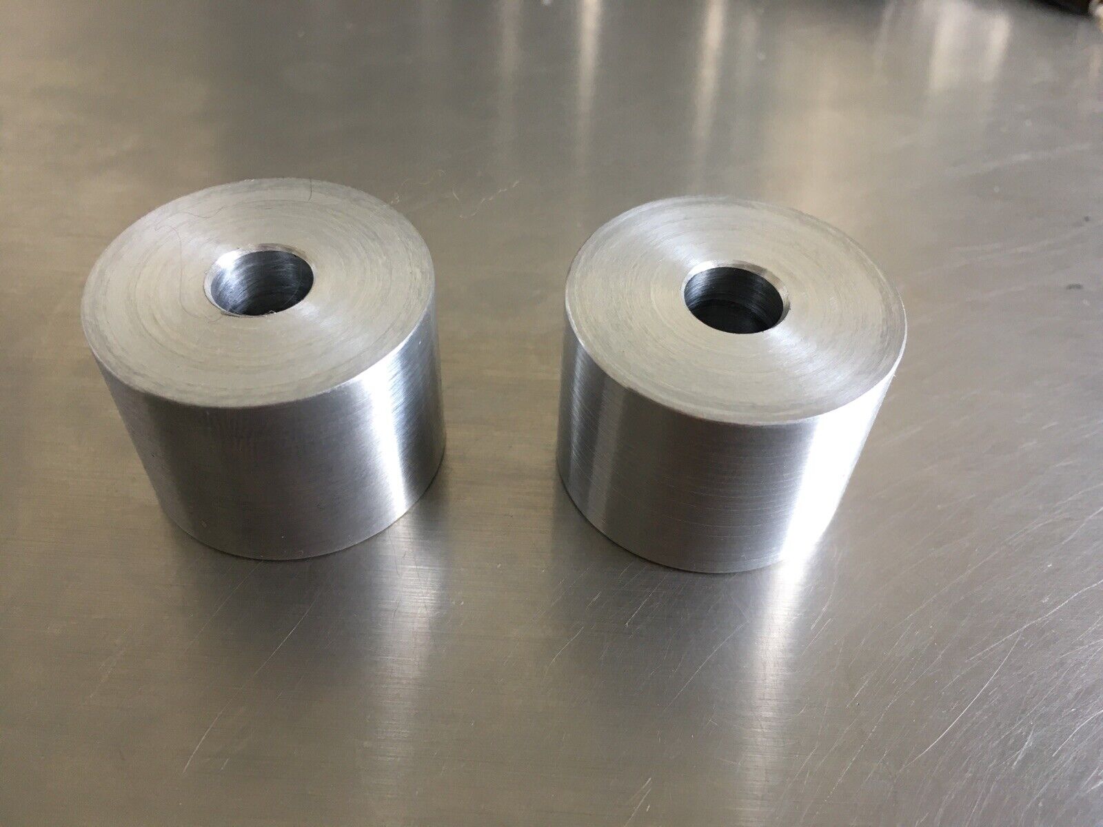

The Jack Be Quick risers may no longer be available from our forum member but I just found a cheap alternative who will even make to the height of choice.
The JBQ ones look great but I believe @VABird is no longer making them.
I just found another cheaper supplier of a more basic design though he offers to make them whatever height you want. buy multiple sets (up to 4) and they drop 2 pound to just 11 quid a set.
Price: £12.95 each pair/set
TRIUMPH 1200 SPEED MASTER BONNEVILLE HANDLEBAR RISERS ***SOLD AS A PAIR*** | EBAY
Add spacer height to the original bolt length when buying new bolts. You will need to.
