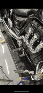

I have the footboards on my 2008 Rocket III, but Im more of a pegs/levers guy. Also I dont like to have my legs up front. I know the brake cylinders and brakelines are different between my 2008 Rocket111 and the Roadster.
The question is how big is the difference, is it a straight swap with minor mods or a completely different system that is not interchangable?

It’s a straight swap just rails pegs and brake line I have classic pegs if you interested in swapping for your floorboards it’s more of a mid peg with my my set up if you’d just need to swap them no brake line change

Im swapping for the Roadster rear set pegs. Classic pegs and floorboards way too front set for me.
Edit: the picture of the floorboard is from my Rocket.

Ok if you do sell them keep me on the top of the list and Yes all you’d need to do is buy a roadster brake line and if you trade your boards for roadster you
Could see if the person just trades the metal lines they need yours anyway but if not heres a link it’s the metal one #25 Rear Brake Master Cylinder, Reservoir & Pedal - Roadster replacement parts for 2012 Triumph ROCKET III ROADSTER
