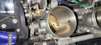

My "Custom" throttle stop, I got sick of the Triumph tomfoolery and modified this gold bolt to the exact correct length.
