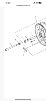

Looking for a set of spacers, front classic/roadster. Used or new, thanks

Are they same for Classic and Roadster as they changed front axle assembly with ABS Roadsters and axle fits from opposite side to early models?
Yep, but still same part number.
Roadster ABS
T2000406 - SPACERSTEPPED​

Earlier pre ABS Classic etc.​

Thanks Ish, that is the part, im getting it figured out. The different axles and such. I bought a front end off ebay and i had a classic front rim but it does not fit with the front end, axle, and spacers i bought. The alignment is off, so im trying to figure out what spacers will work with this front end wheel combo. No biggie just mixing matching parts needs alittle massaging for correct figment. Im having to measure and get rim lined up for calipers, its coming along. Waiting on a swing arm bearing from bearing dist. and ill have a roller. You think it looks fast?

Might want to just take measurements, do the math, draw it up and pay the $50 for a local shop to make them for you.
Not sure if what you need exists as it's mixing matching stuff. Idk but that's what I would do
Roadster axle, it has a shorter collar on it from the other axle. Front sorted. This rim is 156.33mm bearing to bearing outer edge. Anyway front is sorted for roller purposes. Movin on to rear.
