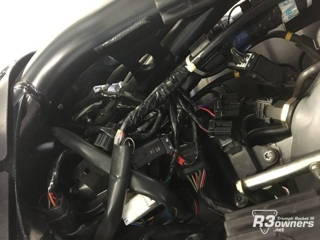

86’d the Signal Minder option and just ordered the Safer-turn-system. Not real keen on the idea of cutting the wiring harness but it just sounds like a better system for what I’m after. Just looking for indicator cancelling, no 4way flashers or running lights. Plus a coupon for 35% off and free shipping sure sweetens the pot.
My STS module showed up yesterday and I installed it this morning. This gizmo is really cool. It Actually does what it’s supposed to do. Let’s hope it holds up
After just one day I was so impressed with the STS module. I reinstalled it on a more permanent basis. I removed all the bullet connectors and used a more waterproof reliable connection system.
