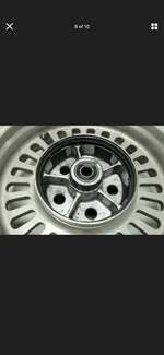

Refer to image, had been hearing a rattling in my rear wheel, found the stuff in the image bouncing around but captured in the wheel.... must be from manufacture...

I'm trying to visualize where these would be found. By "in the wheel" do you mean inside the tire or inside the bearing hub? How big are those pieces (no reference) and what are they made off? I'm guessing casting flash or plugs????

See attached photo as an example of inside the wheel ... pretty sure it’s casting flash and they’re about 20mm diameter... made terrible noises spinning around in wheel as I’d accelerate...

Ah, so it is from the cush drive hub area. I agree with your call. Casting flash. Bet that didn't help with wheel balancing??
Funny you should say that... I had been wondering if the balancing is a bit out.... oh well, not much left on the rear tire anyway so in a couple of months I’ll find out
