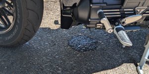

Been reading a lot of threads and service instructions. Google giving me some conflicting information linking to older Rockets. Think I figured it out with the instruction links. Here is what I did just in case.
  1. Moved bike on level spot
  2. Warmed it up for about 90 seconds
  3. Let it cool for 3 - 4 minutes
  4. Cleaned Dipstick
  5. Checked Dipstick again
It APPEARS to be overfull of oil. I don't see any hash marks other than the grid. Reason I'm checking is I found a small puddle of oil after my first ride over 5 miles after an oil change. The oil on the ground is "clean", i.e. pinking/purple other than dirt from the ground or grime it picked up on the way down. Am I reading the dipstick right?

That appears to be overfilled, but I often have to turn the stick over to see the true level- it sometimes smears on that side coming out.
Did you do the oil change or a shop?
Clean the bottom of the engine and look to see which of the drain bolts is leaking (or is it from somewhere else?). Is there a washer on that bolt?
Agree that the leak location indicates a loose oil filter (most likely) or maybe one where the old seal was left behind before the new one is installed, but that usually results in rapid loss.
As far as oil level, I've found that when I measure hot but otherwise follow the procedure, it's hard to read or seems very high. But if I follow the procedure to the letter (cold engine, level and on side stand, 75 seconds run, 3+ minutes to settle) I get a consistent reading. Since mine is losing and possibly consuming oil, I have to check relatively frequently.
Yeah always check when stone cold. If the oil filter is leaking you probably have air getting in also, showing higher oil level. As long as it isn't low, the dry sump system isn't going to cause wet sump problems like crank slap or aired up oil. Don't worry if it is a little high on the stick. The more the better for engine cooling. You just don't want it puking out the pie hole.
OK so follow up. The oil was leaking somewhere out of the front, behind the water cooler. I got down to remove the lower water cooler section, and it was missing a screw. Removing the other screws and started to peel back the water cooler, could see puddles of oil around the filter. Above the filter was dry. Filter wasn't even hand tight. Turned it 2 or 3 turns before it even felt "hand tight". Its been a year, maybe 2 since I have had the oil changed on it, but only put < 300 miles on it according to the odometer. Dealer changed the oil last time. Called them and they will take a look at it and fix it up, if they agree their problem, no charge.
