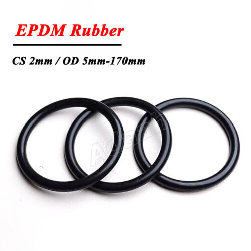

Look like i need to find EPDM version O rings.
I bought from ze Germans but this low cost UK source seems to have come up since.
Though the actual item location is China so delivery time will suck vs. Germany.
Just watch out they sell by OD rather than ID so allow for that.
Measurements of Oberon slave & their inadeqaute Viton o-rings (note these are swollen o-rings from their reaction to DOT4 - I've found 2.0mm gauge o-rings work fine). IDs of the 2 rings needed are 46 and 44mm. Note again those UK lads above seem to sell by OD not ID.
