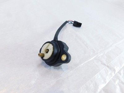

i did not explain my self correct we are not looking for the gear sensor part
what he is going to need is the spring and cap (don't know what its actual name is) that fits it into the shifter shaft.

thanks so much this will let this poster look at what i have been trying to explain to him and may be buy what he needs

You have sent pictures of three different sensors. Mine is similar to the one in the middle. The other two makes much more sense though? It is in the middle of the night right now here in Sweden. Will take a look tomorrow.
Best regards Torsten
Tried to remove the cap and I was wrong not plastic. After some work tring to remove it the connexion to ground is also on the cap. Wd40 may have removed some corrosion. But still stuck.
In the meantime I have found a service bulletin replacing the sensor and harness as Ishrub posted.
Also I have found info(correct or not?) that it is possible to disable the changes in gear position for the ecu. (Adjustment of the ignition?)
