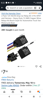

Never been happy with my 06 and hot starting. Cold starts are fine. Hot starts are hit and miss. Many say get heavier battery cables, many put heavier starters on, none have worked for me. This is the issue with Rocket 3’s that just infuriates me. I carry a Lithium Ion battery jumper and I keep it charged. I think the root of the issue is the contacts on the solenoid. Mine solenoid clicks, but the starter won’t engage. I have found no way to improve on the solenoid contacts.
