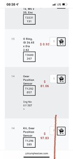

BINGO (two versions)​
THIS IS THE first R3t VERSION - LAST 6 DIGITS ON YOUR VIN before and up to 611306​
T1296589 - SPARES KIT GEAR POS​
  • Reference 14​
  • Part Number T1296589​
  • Description SPARES KIT GEAR POS​
  • Notes > Eng No 611306 - ** See Tech News 143 **​
  • Price Au$188.20​
Same as​
09 / 17 Triumph Thunderbirt 1600 Gear Position Sensor Harness OEM T1296589​
This is the later version - last 6 digits on your vin 611307 onwards​
T1292057 - GEAR POSITION SENSOR​
  • Reference 14​
  • Part Number T129205​
  • Description GEAR POSITION SENSOR​
  • Notes Eng No 611307 >​
  • Price Au$160.20​
For Aussie buyers they will deliver but hunt locally first.
Postage should be cheap if they just put it in an envelope for you. They will post to Australia.

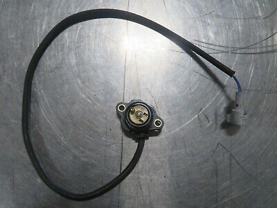

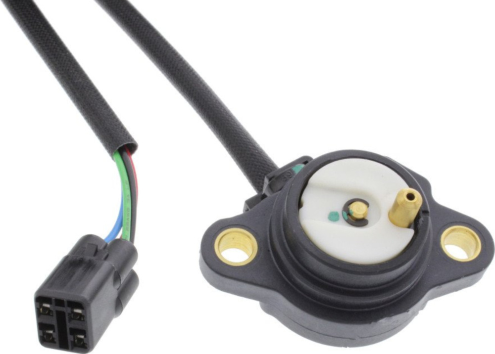

It gets very confusing to all and many errors appear online but the first eBay listing I posted 2010 T/bird had a plug that may fit the earlier oblong connector. The later eBay listing T/bird one is definitely same as your 4 pin square plug.
