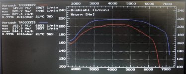

Fifth gear hp at clutch (rwhp was 141/172).
Second graph is torque in Nm.
Top Speed in fifth gear was 244kmh (OEM speed cutter is at 230kmh.)

@Penner These figures are at the wheels yeah? Did you update the previous maps on TuneECU or upload "new" free maps with the speed limiter removed/raised?
It is clutch hp. At the rear wheel it is 141/172.
There is no update to the free map yet. It is on the safe side.
But the good news is, that it will still get you pretty close to any costum map.
