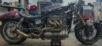

209.099 at the 2024 May SCTA El Mirage dry lake land speed event.
8750rpm through the traps at about 1.59 bar intake pressure at peak rpm (8ish psi). Had a little jump over two ruts in the middle of the track at about 180 mph, or it would have been a touch higher... it was only wide open for the last few seconds of the run. This thing is a bullet train, and it's still going to get faster.

It's pretty close to topped out there, unless I give it more rpm... 9500 rpm is a lot of piston speed. The plan is to change the gearing, build a body, and go 250+ on the salt.

The previous minimum/record was under 200mph, so I was running a Q3 Dunlop. When I go back in Nov I'll have to run a pirelli slick.
Edit: haha, just saw your edit. To clarify, if the minimum or record for the class is under 200, they let you run a Z rated tire. Now that I've set that over 200 at El Mirage, I'll have to run a "race" tire in that class if I want to be teched for over 200. Race tire pretty much means a slick. I'll buy an off the shelf SC3 Pirelli before i try to carve up a street tire. At boneville all 4 classes are still under 200, so ill finish of this tire there. This is the scta rule book.... the AMA/FIM has a slightly different approach. :)
Gas is c16...we run it in everything, even if we run fuel class. It is probably the highest octane, non-oxygenated gas out there. Terrible choice for anything other than hot running turbo motors, or obscene amounts of nitrous.

El Mirage is shorter (1.3 mile) but it is more of a trap speed event, and you only have to do one pass to set records. It is a good test n tune for bonneville, and run under the same rule book/people that do speed week. I'd highly recommend it if you need to do testing for speed week. They run once a month from May to Nov, aside from August.
