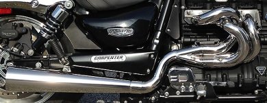

but i am going to do a custom exhaust by using the Carpenter sidewinder manifold
but do a true 3 pipe vs a collector like in this (i know im going to drop some HP not doing a collector but i may find a way to do a hidden collector where the cat box is but it must appear to be a true 3 pipe system the entire way similar to this video , also ceramic coated inside and chrome outsite

You are going to need heat shields on the exhaust. Before chroming have some small screw bungs welded on. You can see the six Paul Bryant added on mine.
Is that just chrome or is there ceramic coating? My local powder coating ( blue flame) has me assured that they can ceramic coat the inside of the pipes before and or after chrome.
I'm on the fence for chrome as the engine is going to be chrome and it might be a nice contrast for the pipes to be black or something. My understanding is that if both sides are ceramic coated there is no need for a heat shield?
