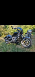

Hi everyone, I’m considering to purchase 2018 Rocket 3 matte black with white racing stripes and only 2000 miles on it. Bike has been sitting for 5 years since owner passed but it starts and engine runs seemingly good. I know I’d need to go over brakes and change oil and battery but is there anything that I should be aware of? I noticed check engine light on but I turned it off after only 5 minutes since it’s parked on slope and wasn’t sure of oil condition- if it gets everywhere it needs to go to… you know what I mean.
I’ve been riding Kawasaki V1 for many years and never dealt with Triumphs. I’ve always played with japs.
Any insight?
