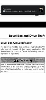

I used Delvac Mobile Lube, full synthetic 75-90w it was pretty clear going in!! I think all the manual call's for is a hypiod synthetic oil
