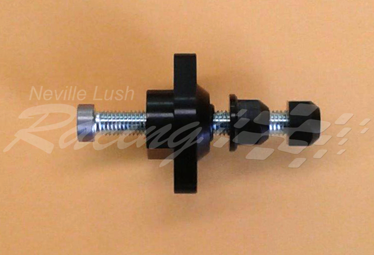

Do you suspect the APE cam tensioner?
I see your going Lush now and giving it a thumb's up!
APE from Carpenter
Neville Lush's version.
IMHOP, I like Nevs manual tensioner better. Im not sure on the plunger diameter but if it is the same size as the OEM unit modifyong the shoe on you cam guide to fit Nevs is No problem. I used a modified auto tensioner on the falcon which I liked and never had to worry about adustment except to check the safety stud. But as manual tensioners go I've had my hands on both and adjusted both and I would run Nevs as a first choice. I'll have to go back and read some more but I agree with the scoping of the pistons. And seeing if the cam guide adjuster side is cracked.
