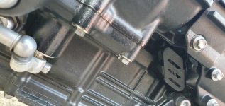

Next fault oil leaking from gear selector . Just fed off faults after faults for a new bike with low miles . So afraid going to trade it in ..

That's probably just the o-rings for the gear position sensor. Easy and quick fix, once you have them. That's exactly where the oil winds up when that sensor is leaking. I suspect someone at the plant isn't installing them correctly.

2k Mileage this is shocking for a new bike. There's movement too . But at moment they stating they won't change my cracked cluster until it fails
