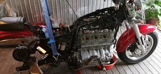

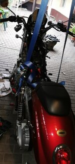

Hi, I'm process of engine removal... Any advice in order to diy/ craft "special" tools that remove the swing arm and engine mounts?

Pulled my engine over a decade ago. I went to the flee market and bought several sockets and filed them to create a castle nut removal tool. The most difficult part for me was pulling the frame off the engine then flipping it to break the case. Hense my avitar.
