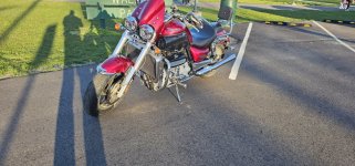

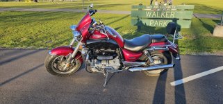

I've been away for many years and am struggling to find answers to questions I have. I have an 05 Rocket classic that I'm installing a ram air kit with torrs and cat delete. Can this be ridden with a 12 minute tune untill I get it to a dealer who is 5 hours away to do a proper tune? I assume no, that's why I'm asking. If not where can I buy the proper cable and tune to install?

Thank you for the info, you got me off to a good start. I'm an old fart also lol. When I bought my bike in 06 I was all over this site and could find everything I needed. Me and the Bike were down for many years and I just got it back running. Trying to navigate now is like learning a computer for the first time, But I will figure it out.
