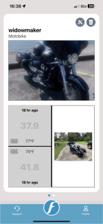

Harley says 36 front 40 rear on touring models for 2024. He probably needs a rear by now😂. Know before you go!

I recently brought some Sykik TPMs from USA & installed them on the bike. I've also just put a new rear tire on & have been scrubbing it in. I noticed this morning upon setting out the front was 41psi & 12 degrees C & the rear was 41psi & 13 degrees C, close enough for this kid. Into the ride I see the front has climbed to 44psi & 16 degrees while the rear is at 48 psi & 33 degrees C. Not saying it's good or bad, just what I noticed. I can see with a higher ambient temp the rear is gonna hit 50 psi during the summer, maybe this is why the rear wears roughly twice as fast as the front?
